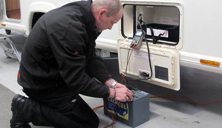

As a starting point, you need to establish the existing charge condition of your leisure battery and a good way to do this is to take a voltmeter reading at its terminals.
However, this shouldn’t be done immediately after a charger has been disconnected because that merely shows an impressively high reading. In fact, it’s usually recommended to let a battery settle for at least four hours before taking a voltmeter reading. Accuracy is important, and another way to get false information is to check a battery when it is still coupled up in your caravan and is still providing power to:
  • A clock
  • A master control panel
  • An electronic alarm system

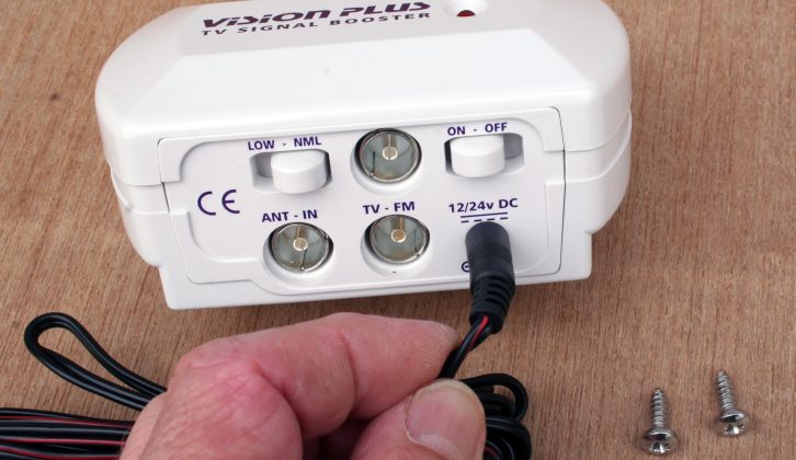

  • Other 12V components, such as a refrigerator control fascia (even though the fridge itself isn’t cooling) and a TV signal amplifier (even though the television is not in use)
Although none of these are ‘power hungry’ components, collectively they draw a small amount of electricity – thereby causing a battery voltage reading to be slightly reduced. To eliminate their interference, a common practice is to disconnect one (or both) of the caravan’s battery clamps.

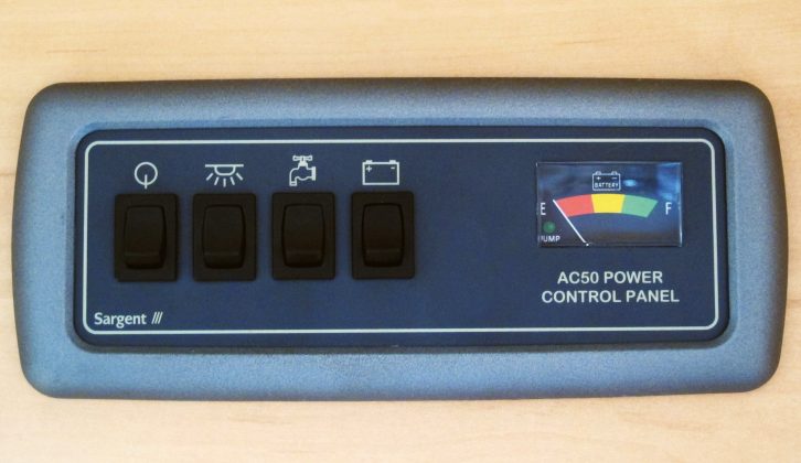

Of course, you may point out that many caravan control panels include a battery ‘condition’ meter, some of which use green/amber/red lights as opposed to a voltage ‘read-out’.
Either way, these devices are not usually as accurate as a purpose-made meter. For example, if the gauge is situated quite a long way from the battery, there can be a voltage drop and this becomes more acute if the diameter of the coupling cable is inappropriately small. Moreover, a light indication system doesn’t normally inform you of the exact voltage, as revealed in the next section.

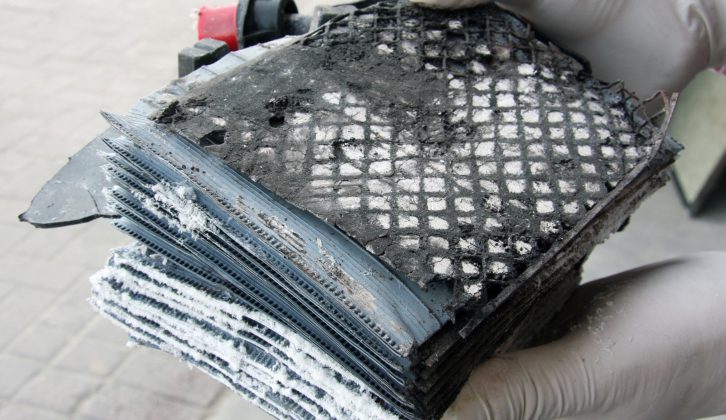

  • Never leave a battery in a discharged state. If recharging is delayed, a situation known as sulphation takes place in which a white deposit forms on a battery’s plates.
  • In almost all instances, sulphation is an incurable condition. When it occurs, a battery is considered to have reached the end of its working life and is ready for disposal.

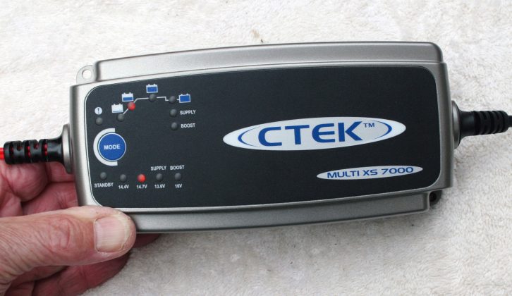

For a number of years, there have been mains-operated ‘maintenance chargers’ that provide a continuous low trickle charge for keeping a battery in a topped-up state. However, the latest maintenance products are more sophisticated than old-style trickle chargers because modern versions employ circuits that react to a battery’s condition and then deliver charging patterns to suit specific requirements.
For instance, if such a device notes that a battery has reached its peak, it switches off automatically even though it remains plugged into a mains socket. It switches itself on again when the charge has dropped.
In view of their ability to monitor the level of charge and react to it, these products are often called ‘intelligent maintenance chargers’. Not surprisingly, this versatility is also available in many of the chargers that also recondition discharged batteries rather than just serving their maintenance needs. In fact, modern electronic ‘intelligent’ chargers often have the ability to provide a regime to suit either wet lead/acid batteries or sealed gel batteries. Some include selection settings for starter batteries as opposed to ‘leisure batteries’. Needless to say, the subject of charger designs is a topic in its own right.
