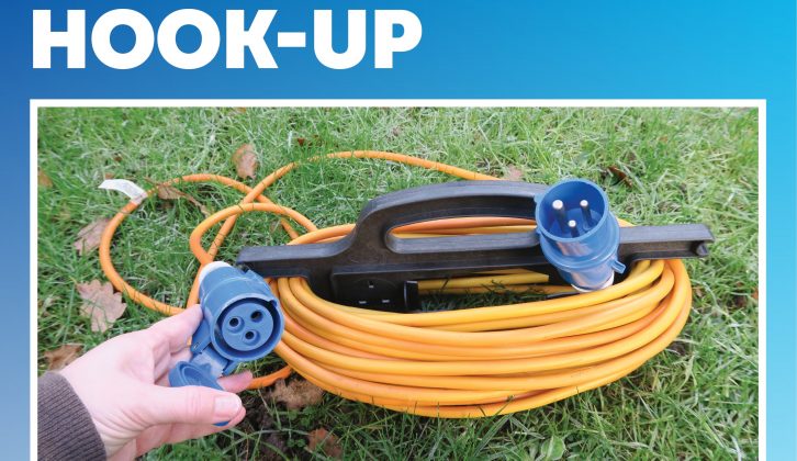

All modern caravans should come with a 25m flexible cable (usually orange, so that it can be seen in the grass, to avoid people tripping over it), with pre-fitted three-pin blue connectors suitable for UK sites. They should comply with BS EN 60309-2.

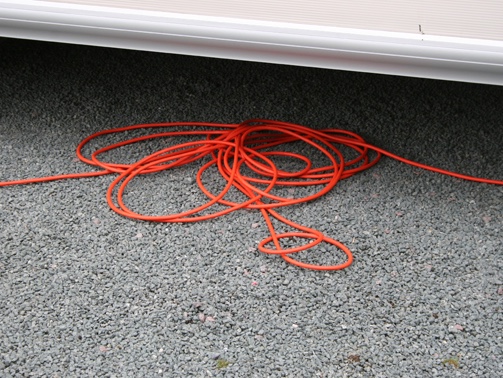

- Fully unwind your hook-up cable and place it carefully underneath your van. Bear in mind that, if you do not unwind it completely, there is a chance the cable will overheat and potentially catch fire.
- Insert the blue connector with the recessed tubes (female end) into your van’s input socket.
- Connect the male end (with the pins) to the hook-up unit, ensuring the cable is lying flat, so nobody trips over it. The current is now flowing to your Consumer Unit.

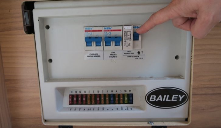

- Carry out a safety check by pressing the test button to confirm the master switch trips out – as it should if anything goes wrong.
- If it does this promptly (as it should), turn the switch on again so that the supply is ready for use.

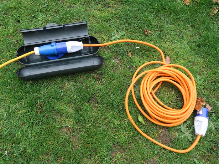

On a recent visit to France, we were quite surprised by the distance from our pitch to the hook-up point. Some campers had to trail their cable across an access road, which isn’t ideal, because there is always a risk that the cable could become damaged.
Our 25m cable reached the nearest hook-up point, but only just – we had to pitch close to a border hedge and run our cable through someone else’s pitch. To avoid this, it might be worth packing an extra 10m cable, a weatherproof plug and a coupler safebox.

- Never leave spare cable tightly wound on a drum
- Lay cable flat on the ground to avoid trip hazards
