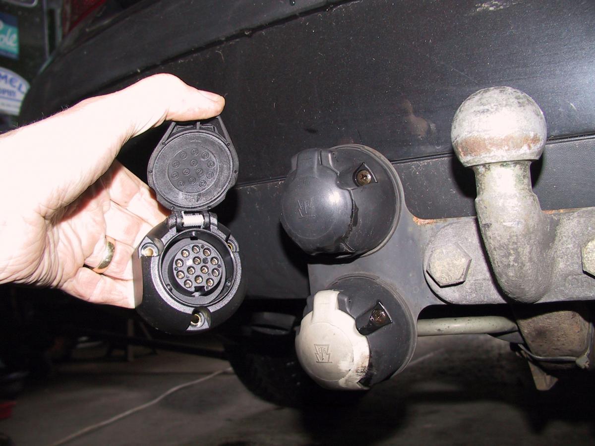

It is a relatively easy task to swap your car’s old twin 12N and 12S sockets for the new European-style 13-pin single socket.

Disconnect the car battery earth, cut cable ties from the towbar and unbolt the towball to release the socket mounting.
[tl:gallery size=460]
Undo the 12N/S sockets’ bolts and dismantle them from the mounting plate. If they’ve rusted, you may need to cut them.

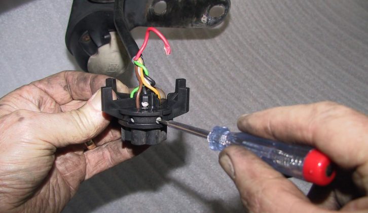

Here, the 12N socket has been dismantled to reveal the cables and terminals. Dismantle the 12S in the same way.

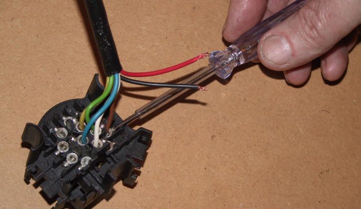

Release each of the wires from their screw terminals. Then slide the grommets and the mounting plate off the cables.

Remove the pin connector from the Euro socket and straighten the wires of the 12N and 12S cables so they are ready to connect.

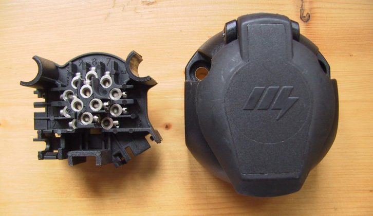

Remove the Euro connector terminal block from its socket casing. You will see that each terminal has been clearly numbered, from 1 to 13.

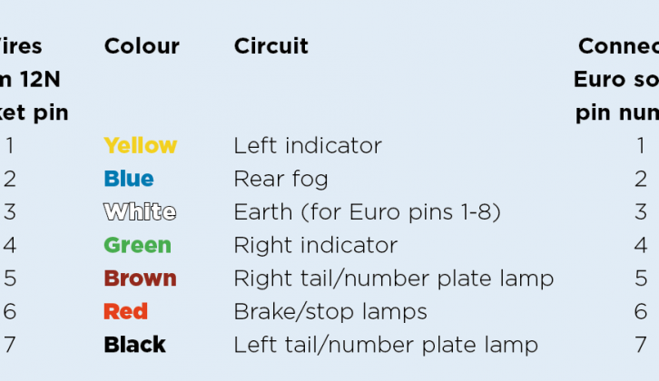

Following the table at the bottom of this page, connect 12N wires to centre terminals 1-4, then 5 and 6. The 12S wires go to the outer ring.

Wiring chart
